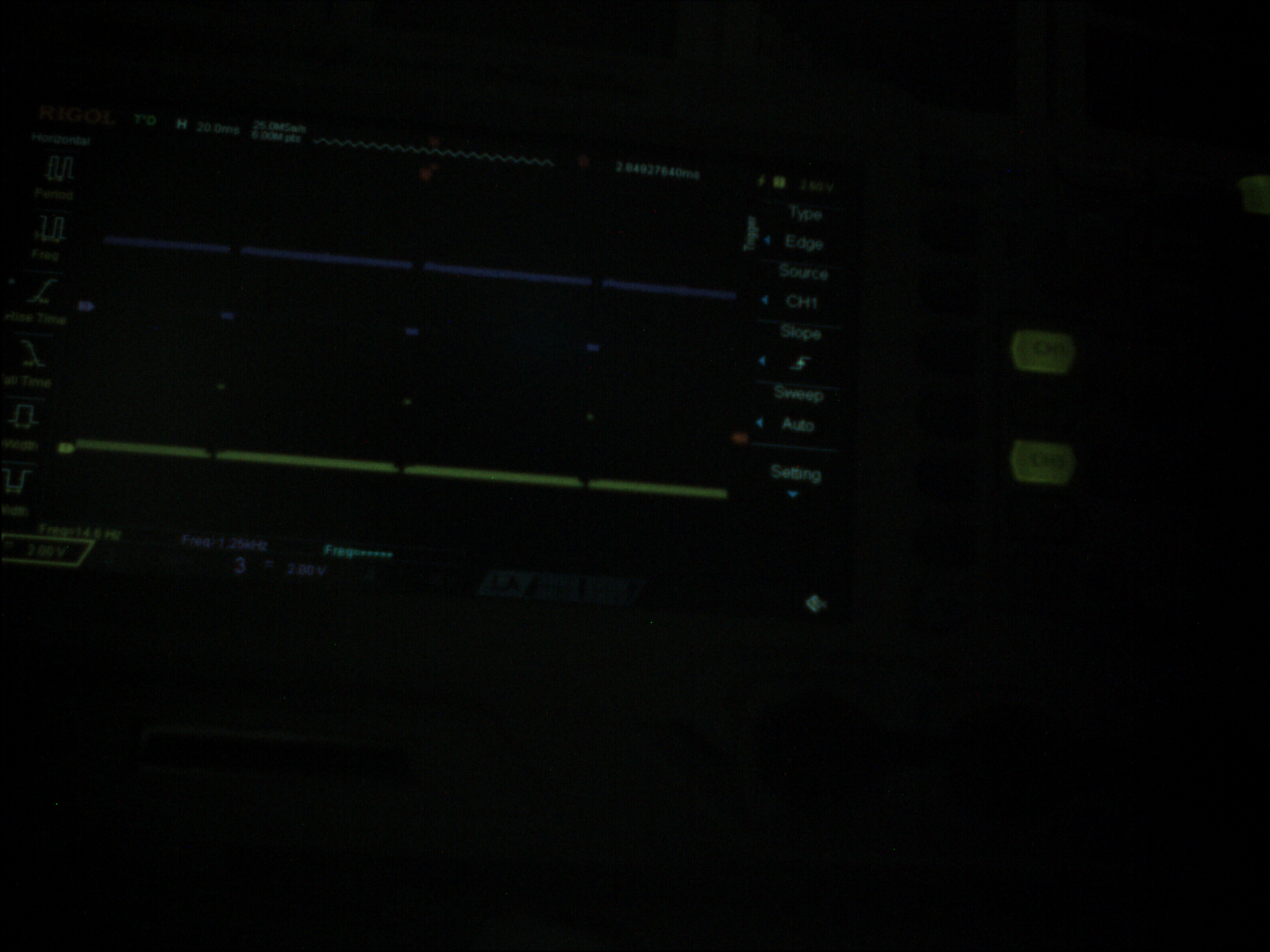

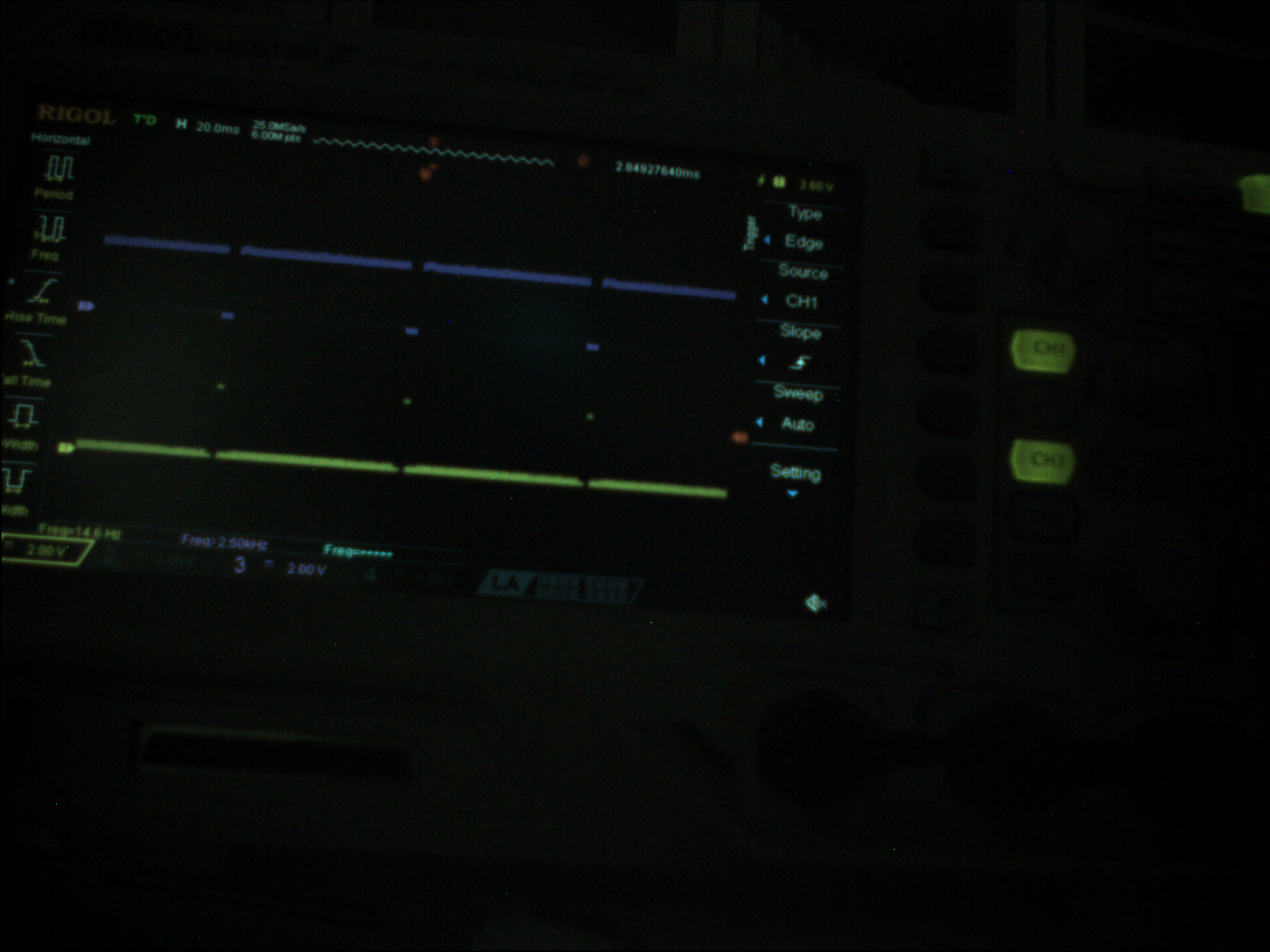

Testing Result
Here we set different exposure value to AEC register at the same light enviroment. The exposure values are 200, 400, 800, 1024 which is in lines basis, and corresponding  to 10.7ms, 21.4ms, 42.7ms and 54.7ms.
