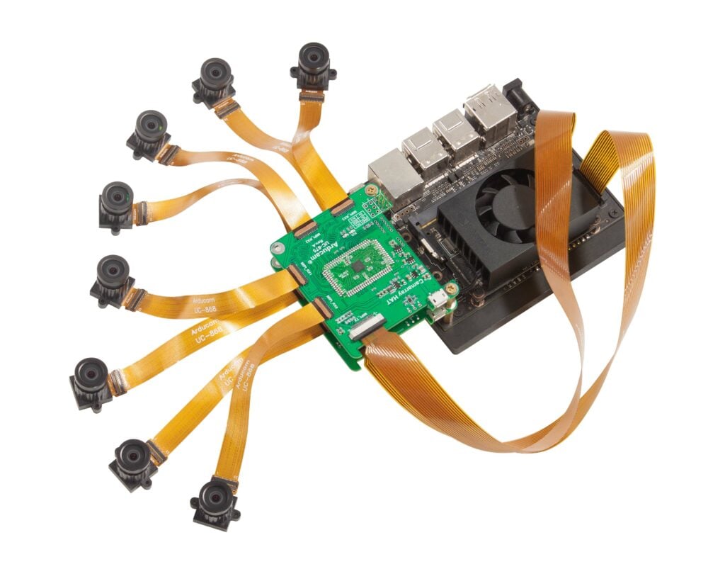

Getting multiple cameras to work on Jetson NX isn’t something new, we’ve done putting 4 cameras to the dev kit, we’ve also managed to have all of them synchronized. We also theorized how the two camera ports can be fully leveraged, whether NX can handle more than 4 cameras, and what you may achieve with so many cameras.
Well, we’ve finally validated our own hypothesis. And it turns out an octopus-like camera cluster works perfectly and looks pretty amazing on the NX.
What you need:
- 8 x Arducam Cameras
- 1 x Nvidia Jetson Xavier NX
- 2 x Arducam Camarray HAT
What you get:
- 8 camera modules working with frame-level synchronization.
- Flexible frame-stitching with any set/all of the cameras.
- A huge selection of cost-effective image sensors.
- RAW8/RAW10 output with 5120 x 800 resolution at an average of 45 frames per second.

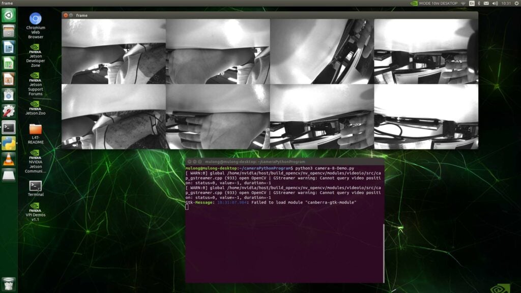

A Screenshot of eight cameras working in a stitched view:
A sample video of The 8 Cameras Working at the Same Time:
