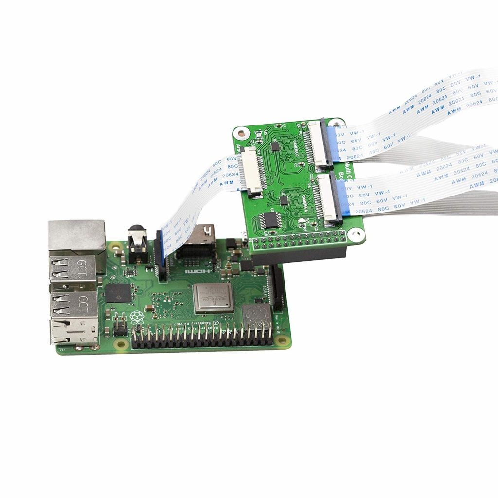

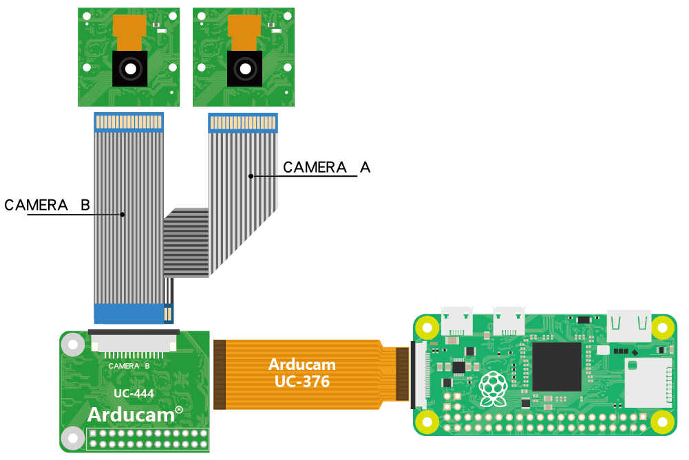

In the last several years, Arducam has designed and released multi-camera adapters for Raspberry Pi in 2 kinds: one allows you to connect 2 Pi cameras to a single Pi Zero, and the other allows for 4 Pi cameras to be connected to one Pi in Model A&B series. Both camera multiplexers are compatible with the standard 5MP OV5647 and 8MP IMX219 Pi camera drivers, so feel free to connect your existing cameras to our multiplexer and see them work as they should be. That being said, there are actually no restrictions on which model you are plugging those adapters into. You can put the stereo adapter where a 4-cam multiplexer is in and vice-versa.
The key point and fundamental theory of these multi-camera adapter boards is multiplexing. The Raspberry Pi only allows one camera to be connected and only recognizes one connected camera, so switching between different channels will allow different camera video streams to be transmitted to the RPi’s onboard CSI port one at a time. Therefore, the Raspberry Pi still connects to a single camera, but you will be able to see in the perspective of multiple ones.
