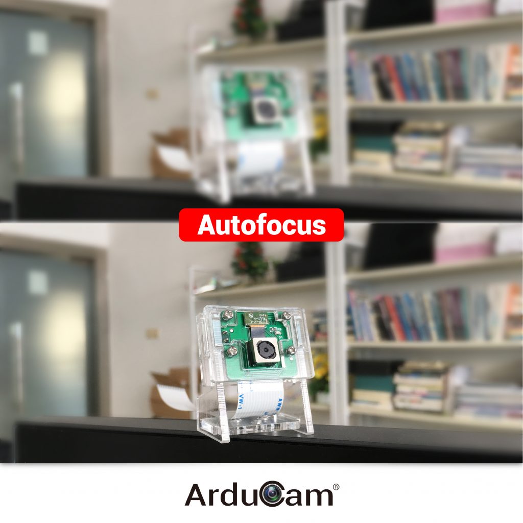

Fixed or adjustable focus
Unlike human eyes, the cameras cannot switch between objects near the lens and those far away easily. Most times the focus of a camera is set to infinity by default, and you might find it hard to see closer objects, just like the official Raspberry Pi cameras.
If a camera comes with a camera lens, such as an M12 or CS-Mount lens, the focus would be manually adjustable, and you can screw the lens further from the thread to focus on closer objects after it’s focused to infinity.
However, if your application required the focus to change from time to time, you would not want to adjust the focus manually each time. The autofocus camera modules come with built-in motors to move the lens, so you can remotely control the focus either by sending commands or use software for autofocus.
