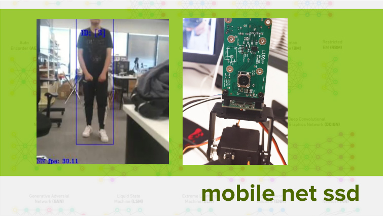

How the systems works:
The OAK-1 is used to
  • capture live video for the MobileNet to do object detection, and to calculate the offset between the center of the object and the center of the frame.
  • convert the offset to Panning/Tilting angles with PID (Proportional-Integral-Derivative) control.
  • report the final results back to the Raspberry Pi.
The Raspberry Pi 4 is used to
  • power the OAK-1 and the bracket.
  • control the OAK-1 to start the camera, run the model and do all the calculation work.
  • navigate the Pan-Tilt Bracket to track the object and keep it at the center of the view.
The Bracket is used to
  • move the OAK-1 so it follows the object.
Please also note that OAK-1’s onboard camera (IMX378) features an autofocus lens, so it can keep the object in focus while moving along with it. The bracket draws power through the Raspberry Pi’s GPIO pins, it can also be powered externally. Even though object detection is done with MobileNet-SSD, which is a pre-trained model to detect as most as 21 objects, you can use other models to detect and track more things.
