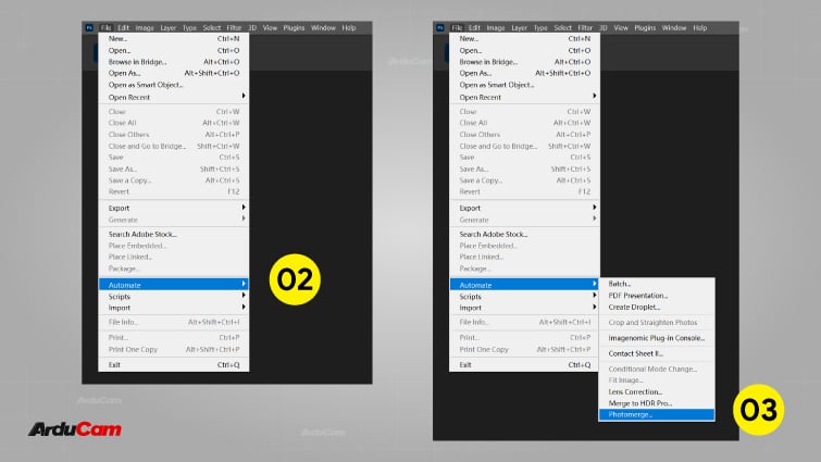

Open PS, find and click ‘file’.
photomerge2
Find and click ‘automate’ – ‘photomerge’ to open the Photomerge window.

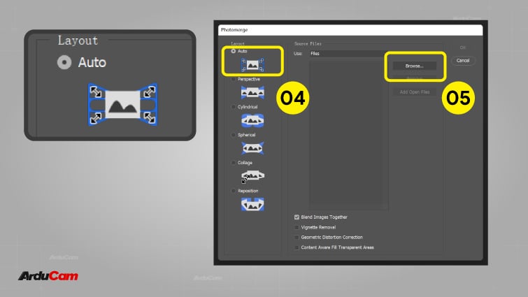

Make sure the layout mode is ‘Auto’, then Click ‘browse’ in the Photomerge window.
photomerge4

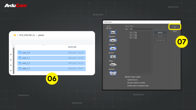

Find and select all the four photos you just took, click ‘OK’
photomerge5

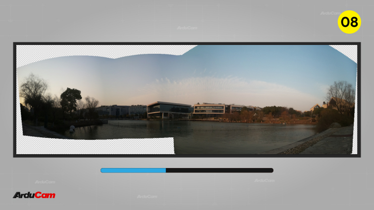

Wait for a while. It’ll automatically merge them.
photomerge6

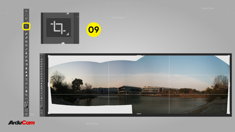

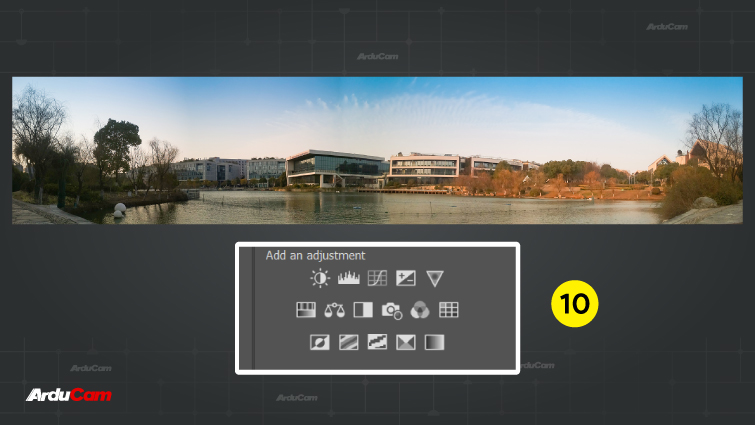

Do the necessary cropping as you want
photomerge7
Do other adjustments as you want.
It’s done!

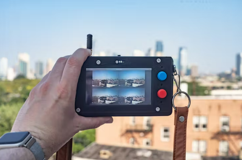

For example, a Wigglegram Camera Kit ……
quadrascopic2
See how Evan Poliquin thought of the idea and made it
Maybe you could create a case that put all four cameras in the same row? Share with us your project with a comment or just write to us.
