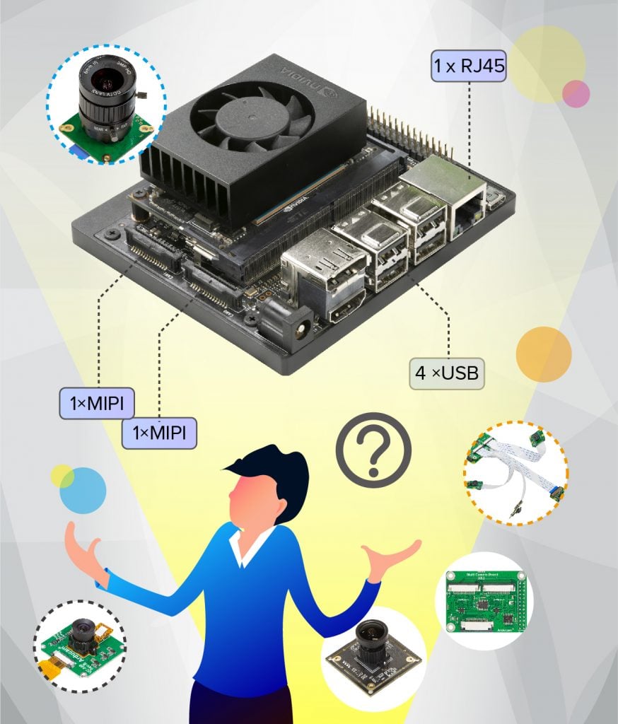

How many camera modules can you connect to one Xavier NX dev kit?
nx dev kit’s 7 available camera interfaces
The official NX dev kit comes out with two MIPI CSI connectors(J1 & J9) plus four USB ports, offering multiple choices for camera connections. The obvious thing is that you can use all 6 of them with camera modules featuring appropriate interfaces, and for savvy users, the ethernet jack (RJ45) can also be utilized with all kinds of IP cameras.
These different types of camera connections have their own pros and cons, what really concerns people is whether these three interfaces can be used all together.
The answer is yes, it’s doable, you can manipulate all the available connectors, open and even access all camera modules at the same time
The NX dev kit can only take 7 cameras in total, 4 via the USB ports, 2 via the MIPI CSI-2 connectors, and 1 via the RJ45 port.

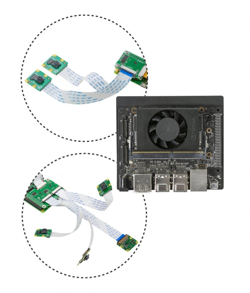

1. MIPI camera doubleplexer & quadruplexer
Camera Multiplexers for Nvidia Jetson Xavier NX
​​​​​These adapters can help you expand the MIPI CSI-2 interfaces on the original NX kit. Let’s assume you have 6/8 camera module V2s or High Quality cameras,  and since they are well supported, you want to use them all with NX, those multiplexers are exactly what you need.
What’s really great is that you can also use them with our exclusive Jetvarity cameras, OBISP cameras, plus all other modules we’ve released for the NX platform.
Drawbacks? You have to switch between them because only one camera is allowed at a time.

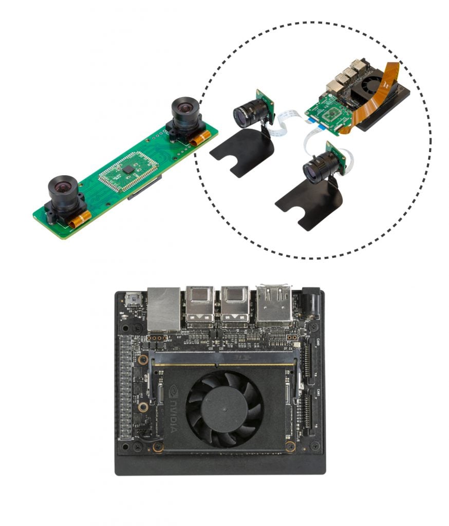

2. Depth cameras & stereo HAT bundles​​
Jetson Xavier NX Dual Camera depth camera bundle
You’ve probably heard of or even tried the Intel Realsense or ZED camera series, these depth cameras are undoubtedly powerful in so many ways and are also compatible with the entire Jetson family.
However, when it comes to flexibility and cost-effectiveness, you may need to look elsewhere. Here are the two types of depth cameras we picked:
Depth camera modules: Everything is packed into a single board, the two cameras are perfectly synced and only takes up one MIPI CSI-2 interface. You can have either a side-by-side output or a stitched view with combined resolutions, they are ideal for ROS and many other NX projects involving stereo vision.
Stereo HAT & Camera Kits: Having a combo like this simply means you get to control all the stuff: the length of the baseline, how the two modules are positioned and even what sensors to use! These are the things you can’t find in a D455 or ZED 2.

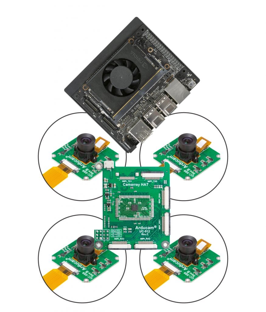

3. Multi-sync camera combiner: Camarray HAT​
Xavier NX with Camarray HAT and 4 camera modules
This Camarray HAT can equip your Xavier NX with more than 2 syncing cameras, it’s an upgraded version of the stereo HAT, a carrier board for MIPI cameras, an expandable stereo vision infrastructure for the NX platform.​​​​

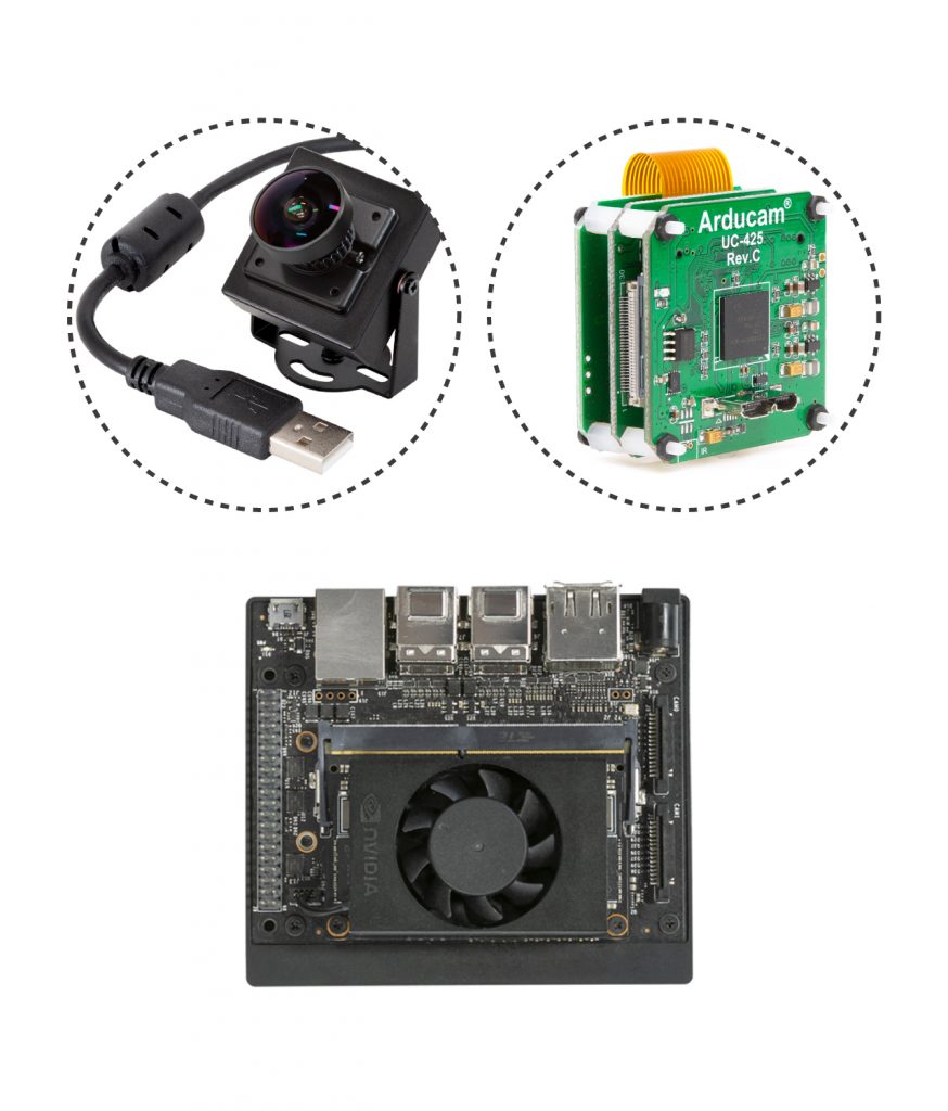

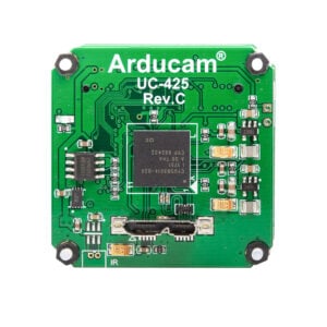

4. Multiple USB UVC Cameras
Xavier NX with Camarray HAT connected to USB cameras
This is the most convenient solution of all and is adopted by a lot of NX users. You buy a bunch of USB camera modules and connect them to the kit, you can even add extra USB ports with some hubs, and best of all, all cameras can be accessed at the same time.
Unavoidably, it has its own limitations too:
Impossible to sync: To have all camera modules in a truly synchonized state, you can only use USB cameras that support external triggering.
Shared bandwidth: No matter how many USB ports you get, the bandwidth that all camera modules are able to utilize is limited to 40MB for USB 2.0 and 5Gbps for USB 3.0 (e.g. if you use 10 USB 3.0 camera modules with the same configuration, each camera gets 0.5 Gbps.)
Our USB camera shields along with dozens of image sensors are here to address these problems. With them, you get to leverage full USB 3.0 bandwidth to connect more modules and external trigger support for synchronization.
More about USB cameras:

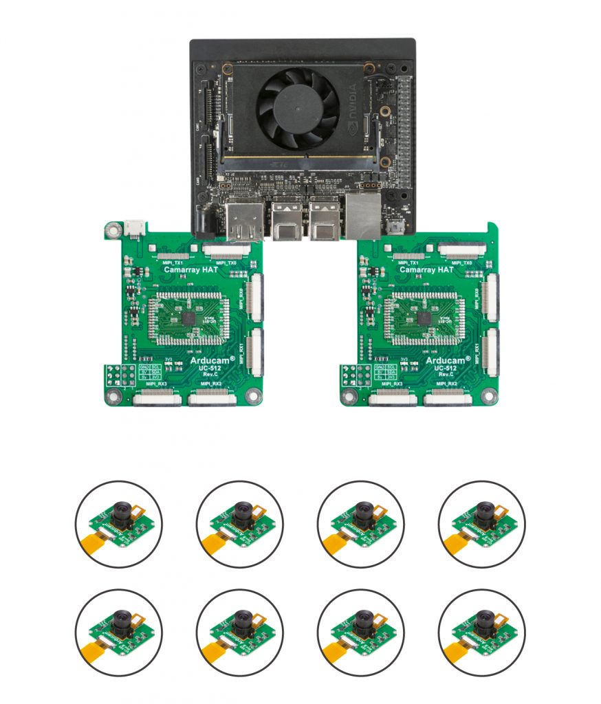

Camera Clustering on Jetson Xavier NX
NX with several Camarray HATs and dozens of camera modules
We’ve talked about the disadvantages of using mixed interfaces, so how to build a truly deployable camera cluster system with the Xavier NX?
You need only two things: Camarray HATs & lots of MIPI cameras.
Every Camarray HAT can support 4 cameras, the official dev kit offers 2 MIPI CSI-2 DPHY lanes, and if you use 2 Camarray HATs with each one of them, you get to connect 8 modules.
And if there’s a carrier board that offers more MIPI lanes, you can easily build a camera cluster with more than 8 cameras!
