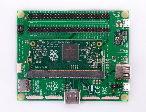

A Raspberry Pi Compute module shares the same SoC with its standard Raspberry Pi model. For example, the Compute Module 3 (CM3) has the same BCM2837 processor and 1GB RAM as the Raspberry Pi 3, just with a more flexible form factor. The compute module takes the form of an SoM (System on a Module) and connects to a carrier board with a standard DDR2 SODIMM connector for I/O peripherals. Besides, you don’t need an SD card for the Compute Module because it comes with an optional 4GB eMMC Flash device soldered on board for the storage.
However, as a major Pi camera manufacturer, what we care about is the extra camera features that the Compute Module can bring. Different from the standard Raspberry Pi models, the compute module 3 brings out 2 native camera interfaces to connect to 2 Pi cameras simultaneously. That means we can achieve many applications that are impossible on standard Raspberry Pi models.

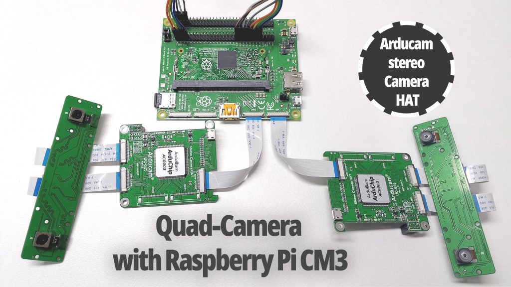

It’s time to give the Raspberry Pi Compute Module a try. The Arducam stereo camera HAT can disguise the dual-camera setup as one camera module in one camera slot, and the Raspberry Pi Compute Modules offers two camera slots.
If we can connect two cameras on the CM3, we can connect two Arducam stereo camera HATs. As each Arducam stereo camera HAT connects to 2 camera modules, it’s possible to get 4 cameras running on the Compute Module.
4 MIPI Cameras Capturing Videos at the Same Time on Raspbian
Arducam has had a multi-camera adapter that can display the images of 4 cameras on the Raspberry Pi. However, the 4 cameras are running sequentially with poor frame rates. Now it’s time for a new breakthrough: we’ve managed to get 4 MIPI camera up and running on the Raspbian, capturing videos at the same time.
It’s not easy to display the images of 4 camera modules, and we need extra hardware and software to achieve that. Aside from the Raspberry Pi Compute Module, we need two Arducam Stereo Camera HATs and two Arducam Stereo Camera Boards.
We could go with 4 synchronized camera modules with the same image sensor or 2 internally synchronized stereo boards with different image sensors. To make it more interesting, we have taken the latter option and used two different kinds of camera modules for the stereo camera board. One is a Raspberry Pi camera V1.3 style OV5647 stereo camera board, the other is an OV9281 monochrome global shutter stereo camera board. The two OV5647 cameras will be synchronized with each other, so do the two OV9821 camera modules.
