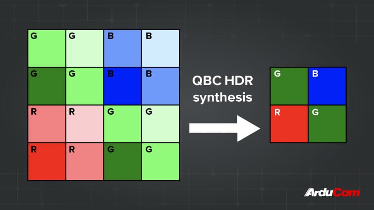

With HDR, You Only Got a Quarter of the Resolution
You can use the new v3 camera to capture both HDR images and videos, and in HDR mode, the sensor achieves High Dynamic Range by doing pixel synthesis where 4 pixels on the same channel (R, G, or B) with different exposures (in the IMX708 case, long, middle and short exposures) are combined into a large one after the readout.
Kinda like this:
Since the IMX708 is a quad Bayer sensor, its HDR output is limited to 3MP. This is also confirmed by David Plowman, one of the main engineers behind these V3 modules.
From some of the sample photos taken by the foundation, and Les Pounder (Tom’s Hardware), you can tell that the HDR images are more vibrant and preserve more details in both the shadows and highlights.
With the latest software, it’s super easy to capture HDR videos with the new V3 cameras, this can come in really handy for scenes with bright highlights and dark shadows.

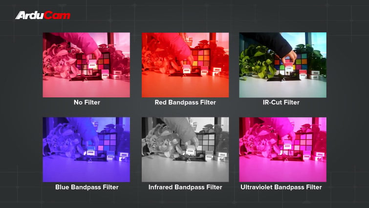

2. Infrared pollution in broad daylight
Without the IR cut filter, the IMX708 sensor is capable of capturing a wider wavelength range than the standard versions.
If you use them in environments that have strong sunlight, the final image/video you get may appear with a reddish tint (caused by Infrared).

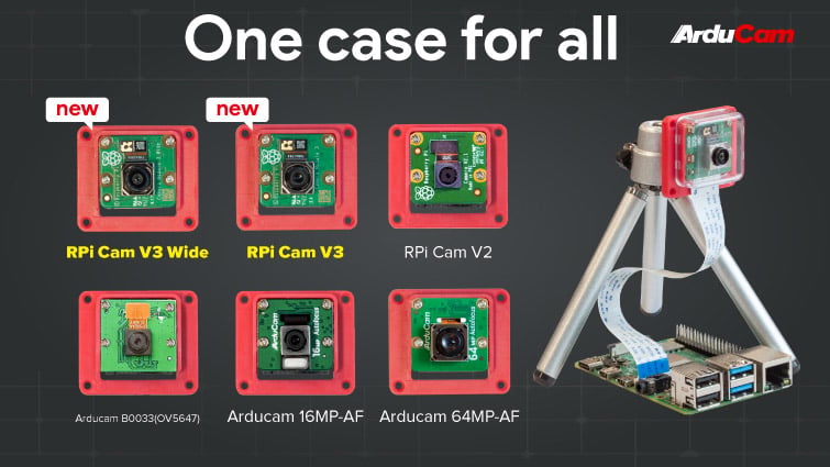

Compatibility with V1/V2 Camera Cases
Mounting the camera is another big problem for many.
Due to the bulky lens design, the V3 camera can not fit into the official Pi zero case, and neither will it work with most of the popular cases made for V1 and V2 cameras.
Since the V3 camera series has a similar lens layout as our 16MP-AF and 64MP-AF, and with the same mounting holes, the camera cases we created for them can seamlessly house the V3 cameras!
Kevin McAleer has also made another cool 3D-printed Giraffe camera mount for it.
