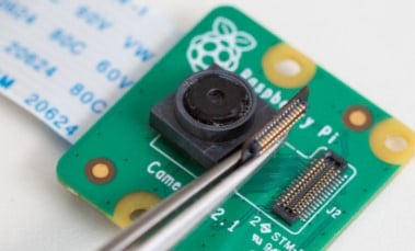

The Pi’s smartphone-camera-like IMX219 module is a combination of lens, sensor, and connector, and is connected to the Pi camera board via a BTB(board-to-board) connector. You can take it off from the camera board once the BTB connector is detached. The trick is, if you cannot replace the lens alone, you replace the lens-sensor-connector combination as a whole, which is to attach a similar smartphone-camera-like module to the Pi camera board, just with a different lens.

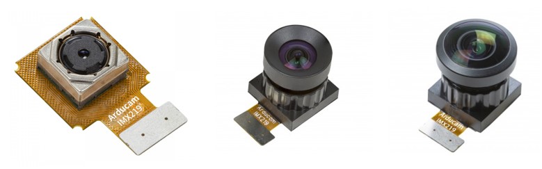

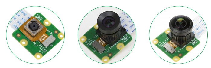

Introducing Arducam drop-in replacement modules for the Raspberry Pi camera V2. They are a series of customized “M12 lens+IMX219” combinations with the same connectors as those of the smartphone-camera-like module on V2 Pi cameras. As they come with an M12 lens holder, it’s easily customizable with various kinds of M12 lenses, ranging from telephoto to macro lens, from zero distortion to fisheye lens, and from manual focus to autofocus lens.
Interested in Raspberry Pi Camera Autofocus?
To learn more about autofocus with Raspberry Pi camera modules, we recommend you read Raspberry Pi Camera Autofocus: The Complete Guide.
Currently, Arducam has 3 IMX219 drop-in replacement modules ready for ordering, and they are low distortion lens, wide-angle lens, and software autofocus lens. All of these modules work with the Raspberry Pi camera V2 natively without any additional software configuration. Just detach the BTB connector, take the original module off, and re-attach Arducam modules to the BTB connector. You are now ready to enjoy the autofocus feature on V2 cameras or see from a wider angle of view as you want. We also accept customization of the M12 lens mounted.

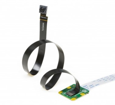

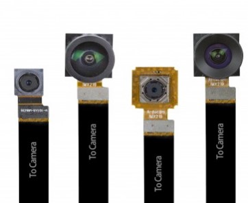

In our case, we designed an extension cable to free the smartphone-camera-like module from the camera board. This extension cable has doubled ended BTB connectors on a flex ribbon cable, and you could easily put it between the camera board and the IMX219 module for the extension.
So what’s the use of the extension then? We might consider the Raspberry Pi camera module a compact one, but it’ll still be too bulky for some applications, especially when you need to put your camera in a narrow space like through a hole or inside a tube, such as endoscopic uses or spy cameras.
In some other cases, the form factor of spy cameras makes it perfect for wearable devices where you can only keep the small sensor module in the front and the camera board in the back with a long but narrow extension cable.
By detaching the smartphone-camera-like IMX219 module from the board, the size of the standalone image-capturing unit is much smaller. It’s also fully compatible with the Raspberry Pi camera V2 without additional software changes and works with all the drop-in replacement modules that we have mentioned above for more complex combos.
