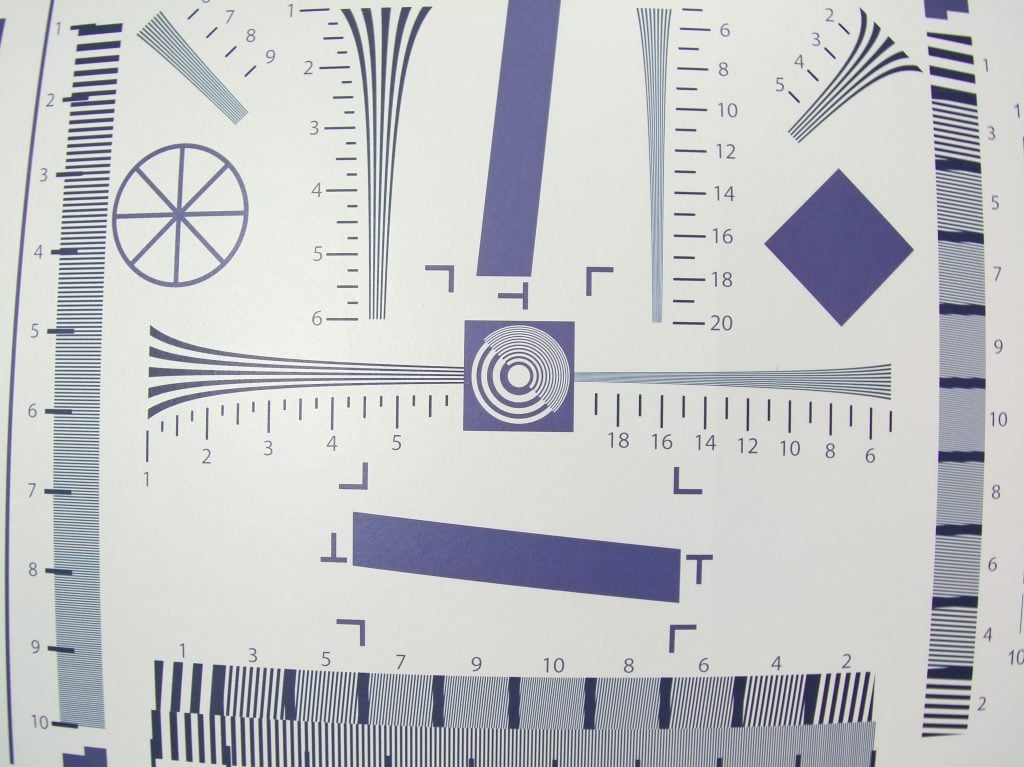

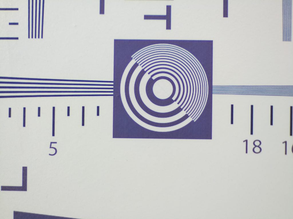

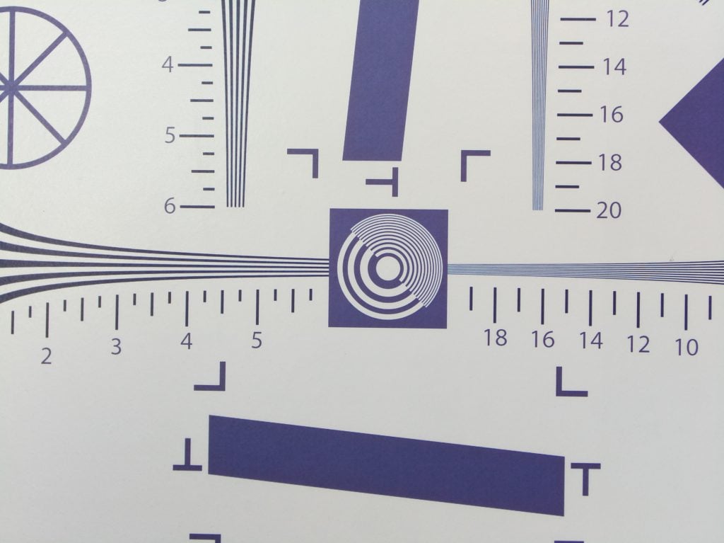

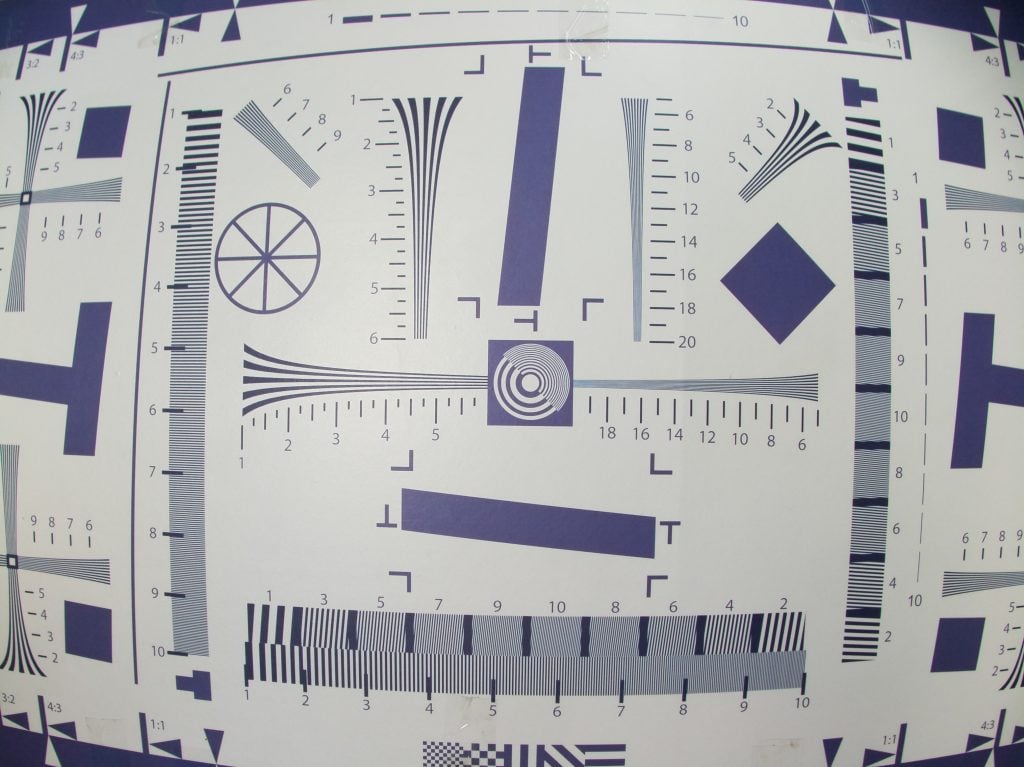

Focal length – The shorter, the wider
Focal length manifests a camera lens’ ability to converge the light, or in a simpler way, how hard it bends the light. If it’s better at converging the light, the beams from different angles will meet each other faster, leading to a shorter focal length. Besides, the stronger ability enables it to squeeze more content into the image frame, so you will get a wider angle. On the contrary, a longer focal length will result in a narrower view and a close-up of details.
6mm
8mm
12mm
25mm
If you somehow find that explanations above inscrutable, here are some photos taken by Arducam engineers with our own lenses of different focal lengths to illustrate how it affects the image. You can see how it zooms in as the focal length increases.

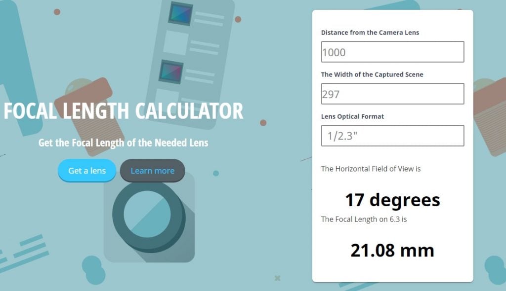

To help our customers quickly sort out the best suitable lenses, we’ve also made a calculator regarding the focal length. For the high-quality camera, the image sensor format is 1/2.3”. Assume you are shooting a landscape A4 paper from 1 meter or 3.28 feet away with this camera, you will be getting a focal length of around 21mm, so a 20mm lens would be a good candidate for this application.

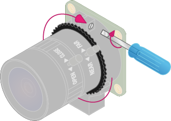

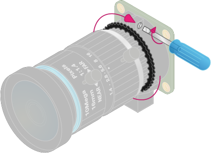

How to Keep your image in focus
There is an adjustment handle on the lens that you can use to focus the lens at the target, which normally marked as NEAR and FAR which means focusing at close-up target or infinite target.

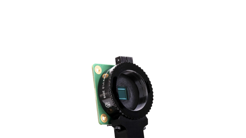

Sometimes you might still not be able to focus the target very well because the back focal length doesn’t match. So, in this case, you can adjust the back-focus adjustment ring to fix this problem. After that, you can use the focus adjustment handle on the lens to do focusing.
To some extent, the C-CS adapter ring is also an add-on to the back-focus adjustment, because the C-Mount lenses have longer back focal lengths than CS-Mount lenses, which is even beyond what the back-focus adjustment ring is capable of. The adapter raises the lens up so the back focal length does not become a handicap for the C-Mount lenses.

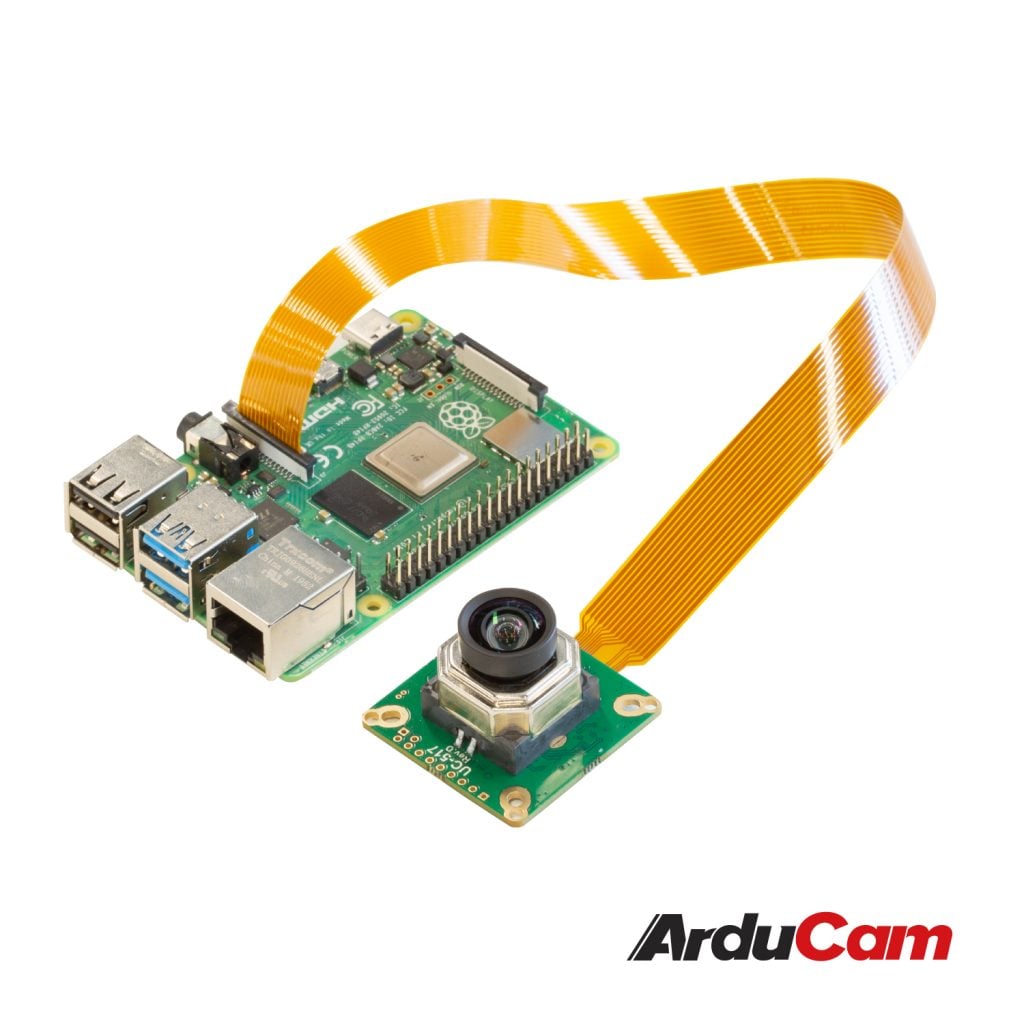

Raspberry Pi High Quality camera Autofocus?
Cameras on smartphones are simple, and they are point-and-shoot. Can the Raspberry Pi High Quality camera be as intuitive as a phone camera to support autofocus, so we don’t have to manually turn the focus ring again and again?
Well, autofocus comes with prerequisites: we need software-controlled motors to move the lens so you don’t have to. The Raspberry Pi High Quality Camera Module neither comes with a focus motor, nor the circuit to control the motor. Therefore, the official Raspberry Pi High Quality Camera Module cannot do autofocus, and 3rd party customization is required.
If you are interested in more about autofocus on the Raspberry Pi, please read the following guide.
Arducam offers a customized IMX477 High Quality Camera Module with I2C focus motor control. The focus of the camera module can be adjusted via software, so you can send commands to the motor either with keyboard arrow keys OpenCV-powered autofocus examples.
Software-Controlled Focus on 12MP IMX477 High Quality Camera: Keyboard Focus Control or Even Autofocus
With a software-controlled focus motor in the lens assembly, Arducam uses OpenCV to automate the focus process on a 12MP IMX477 High Quality Camera on the Raspberry Pi. This is how that looks like. This is specifically about the autofocus HQ camera. If you are interested in the general autofocus topic on Raspberry Pi, we […]

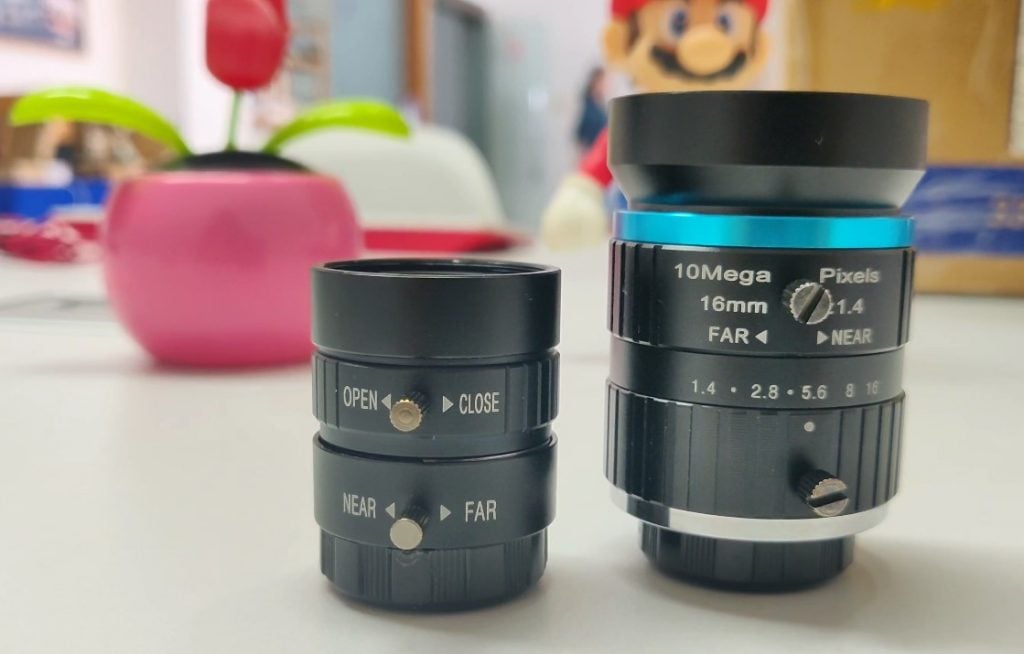

The Aperture works like eye’s pupils to limit the light
The Aperture on the lens is like the pupil of human eyes, and it limits the amount of light entering into the sensor. While human pupil is automatically adjusted, it is manual on these C / CS-mount lenses. On the 6mm CS-mount lens, the aperture ring is in the middle with an “open” and “close” mark on it. For the 16mm C mount lens, it’s the inner ring that’s closest to the camera.
So how does the aperture ring affect the light level? When you turn the aperture ring, you can see the aperture physically opens or closes, and the size of that small opening whole directly lead to differently illuminated pictures.
The size of the aperture not only affects the light admitted by the camera, but also affects the depth of field, or the distance between the nearest and the farthest objects that are in acceptably sharp focus in an image. To increase the aperture will produce a shallower depth, and to decrease the aperture will keep more object in focus.
