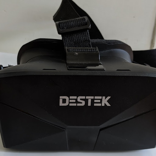

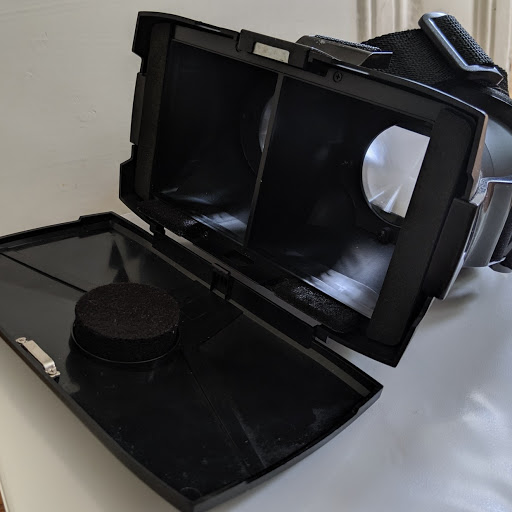

Our class is planning to use a cheap “VR headset” (like the one below – designed to hold a smart-phone) as the chassis for our prototype. On the front (left image) we’ll mount two cameras with lenses centered about pupil-distance apart. The ribbons from these cameras will be threaded through the front cover to the SDC/Raspberry pi assembly, which will be attached to the inside of the front cover. Just behind that assembly will be the LCD monitor, which will sit centered and flush against the divider between the two eyes’ viewing areas (the thin plastic barrier separating the volume in half, visible in the right image)
Also, on the front cover will be mounted multiple IR and UV LEDs for illumination.  If we have to use separate cameras for the UV mode, there is enough space on the front cover to accommodate two cameras stacked vertically.
