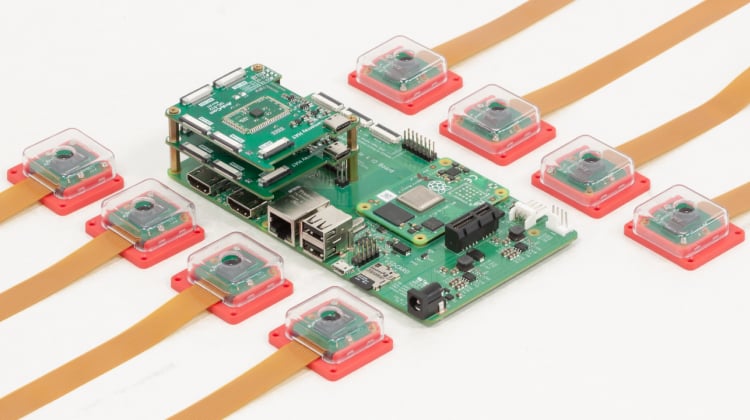

Is running eight cameras simultaneously on one Raspberry Pi CM4 hard?
Well, the simple answer is ‘no’, as long as you’ve got the Arducam Camarray Synchronized quad HAT in hand. To complete the task, all you need to prepare is just two HATs with 4 cameras for each. And we already bundle them together for you, a Kit ready to start.

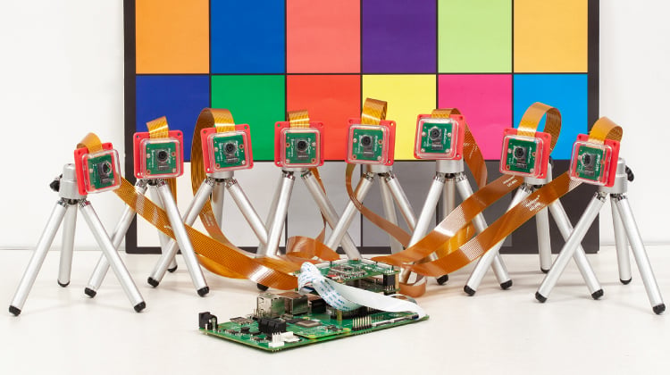

The direct motive for this tutorial came from one of our fan users who recently shared with us his try. Generally speaking, however, demands of multi-cam applications always exist, such as 3D scanners, drone cameras, IoT cameras, stereo robot vision, wildlife cameras, 360-degree view surveillance, face/object detection, live-streaming, and so on.
Actually, believe it or not, speaking of multiple cameras working literally ‘at the same time’* on one single RPi, Arducam hardware is still the only capable solution so far. To achieve such an accomplishment today, we have made three substantial breakthroughs over the years: multi-cam adapter board, synchronized stereo camera HAT, and Camarray.
*at the same time
– For a single HAT, CAM0 & CAM1 are fully synchronous, so it is with CAM2 & CAM3; while there is one frame delay between CAM0/1 & CAM2/3.
– For the 8 cam application mentioned in this tutorial, two HATs are NOT fully synchronous and the time delay depends on actual multiple influential factors

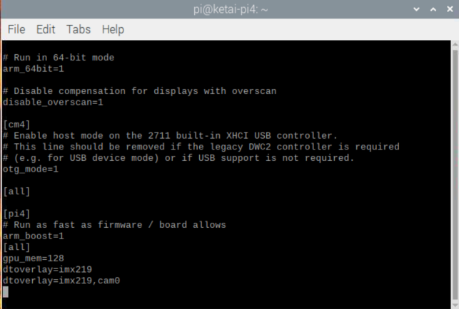

Configuration
sudo vi /boot/config.txt
Modify the config file by adding the below
dtoverlay=imx219 dtoverlay=imx219,cam0

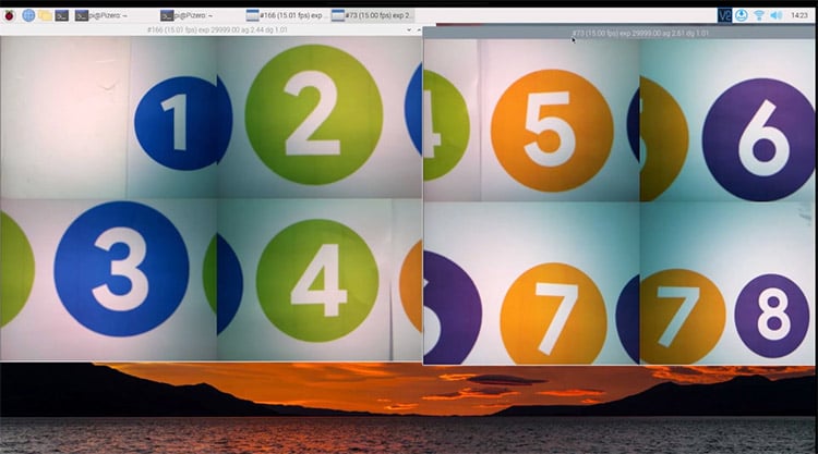

Running Multiple Cameras
Open two terminals respectively.
For terminal 1
libcamera-still -t 0 --camera 0
For terminal 2
libcamera-still -t 0 --camera 1
See the full demo here.
